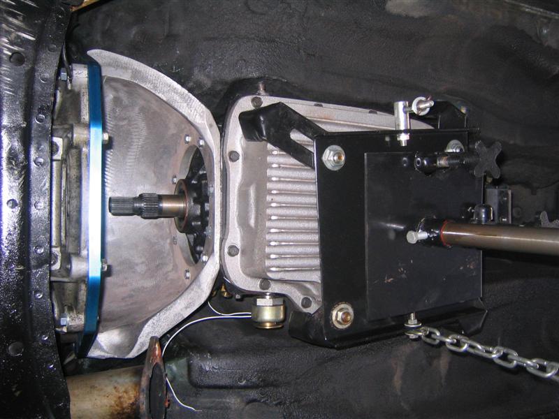

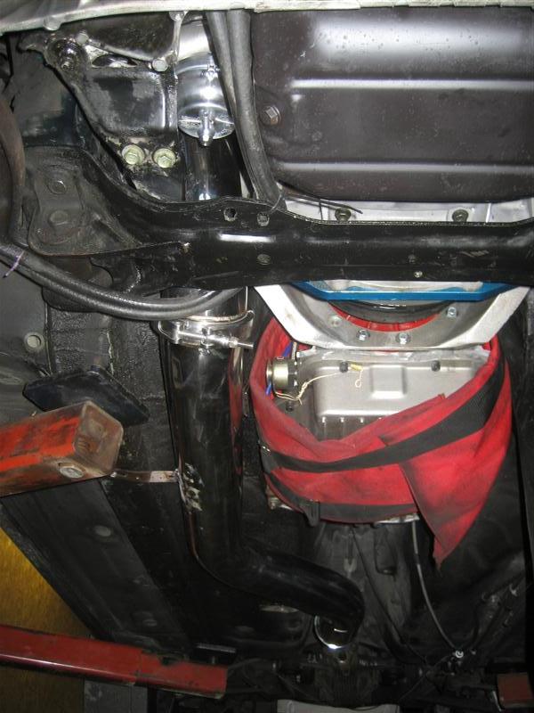

1. got the th400 trans back in, removed the stock bellhousing and replaced it with ultrabell

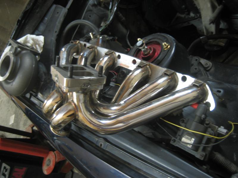

2. tack welded the adapter to the header, turned out really nice.

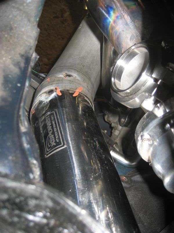

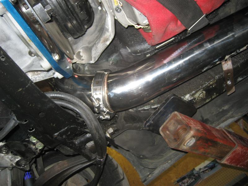

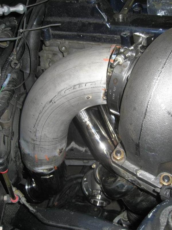

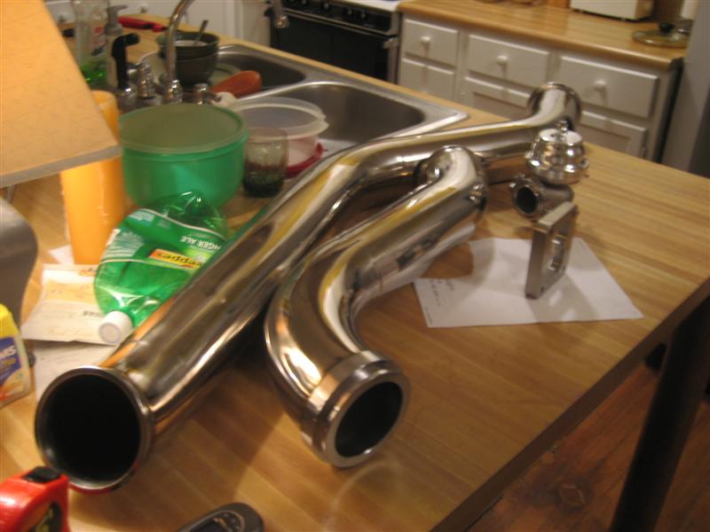

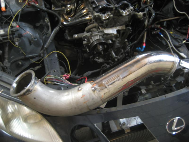

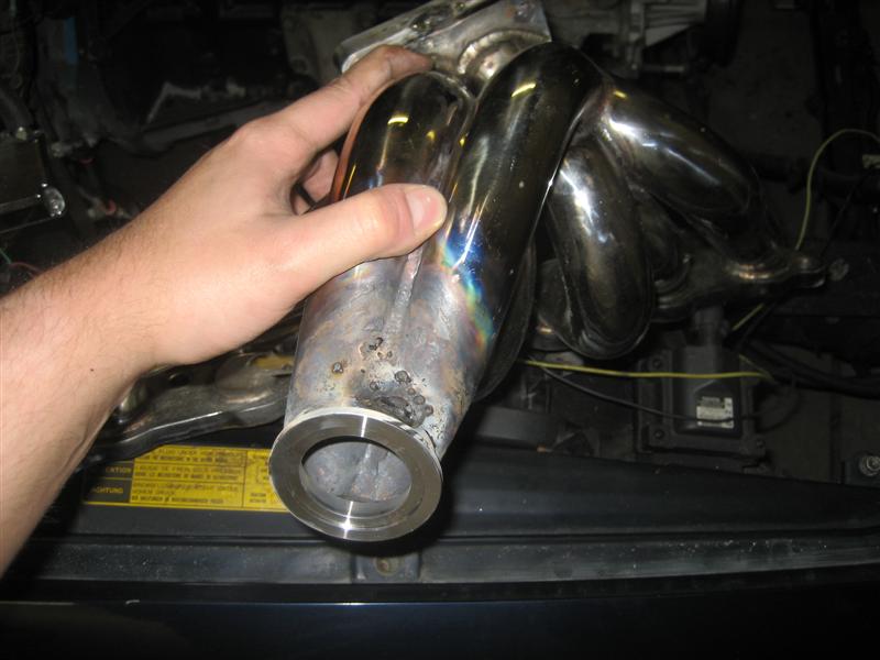

here is the xspower 4" downpipe. Really nice stuff for under $400

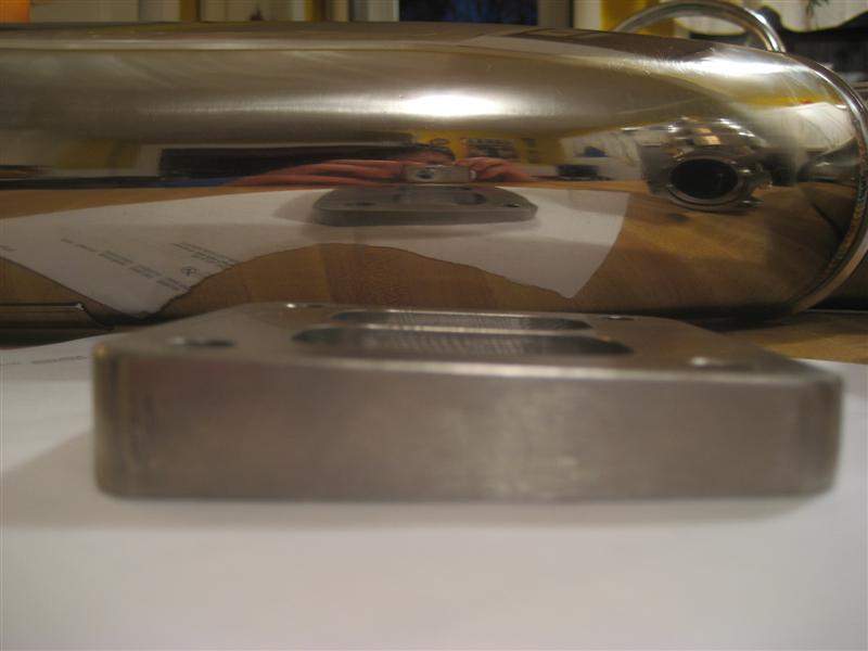

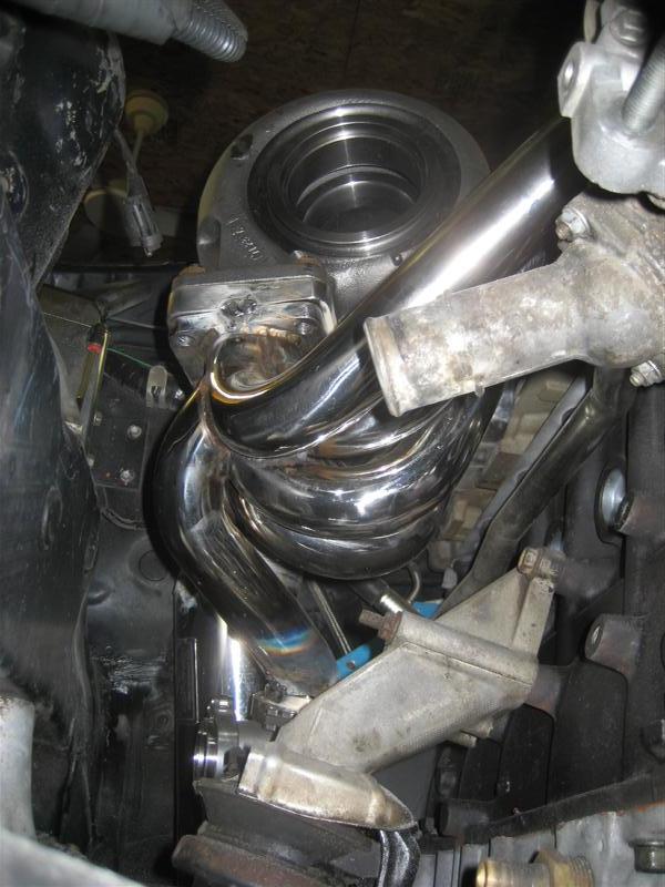

here is the adapter flange i had made. it is 3/4" thick, then it was milled on a angle from 3/16" to nothing to lean the turbo in towards the header. this was then welded onto the stock t4 flange on the xspower header. the exhaust manifold i am also going to brace heavily...

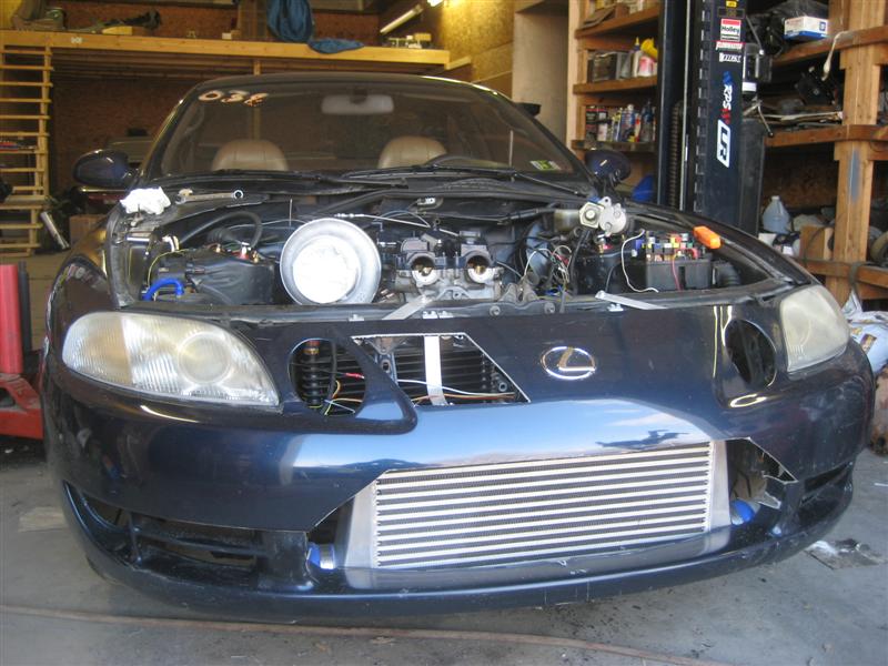

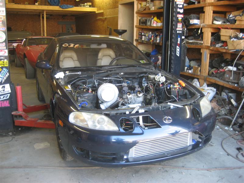

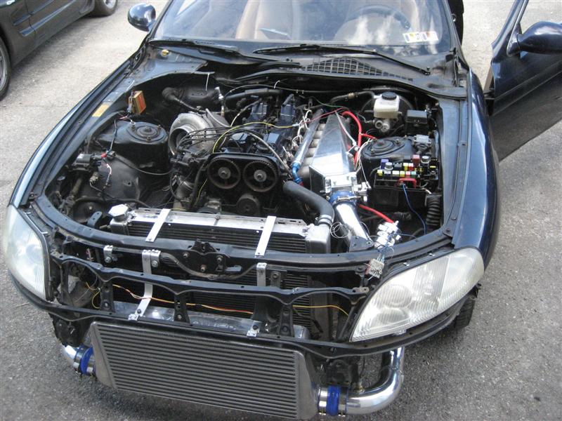

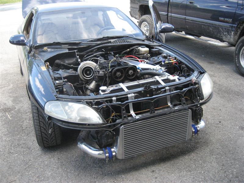

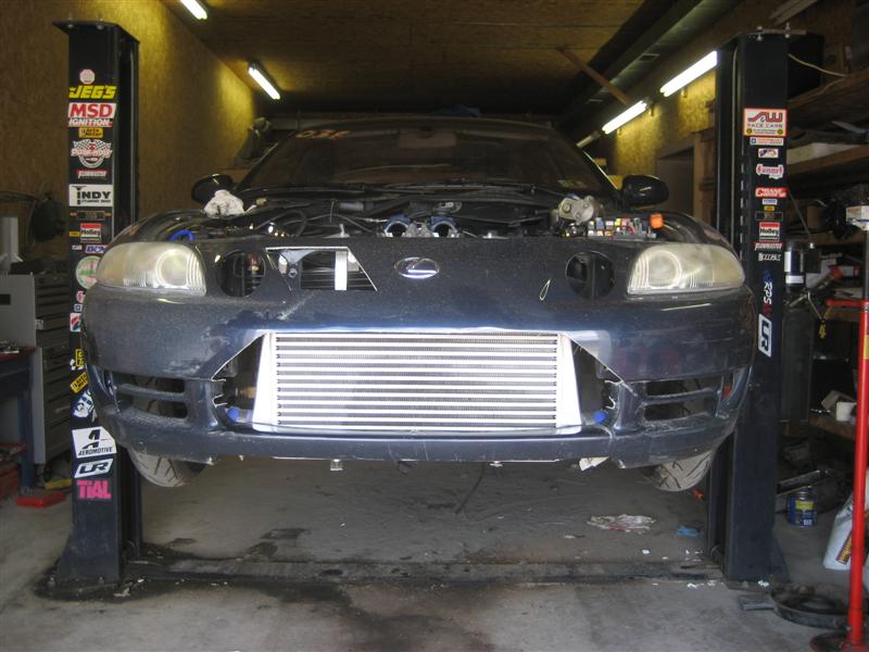

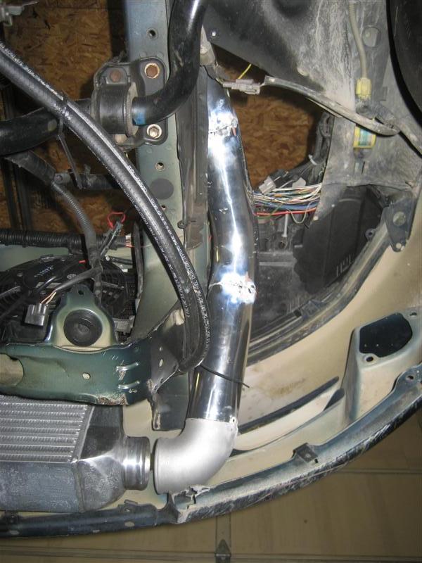

here is the huge xspower intercooler. I cut the front bumper today to give it more flow

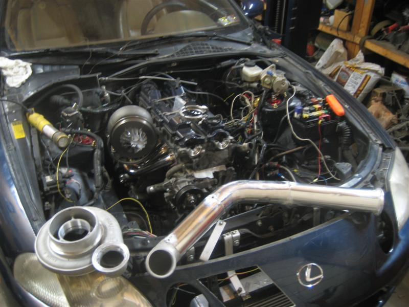

sat the downpipe in there for test fitment... will need a different vband flange and may need to do some cutting to make it fit better with my setup. it's close though! much better than starting from scratch!

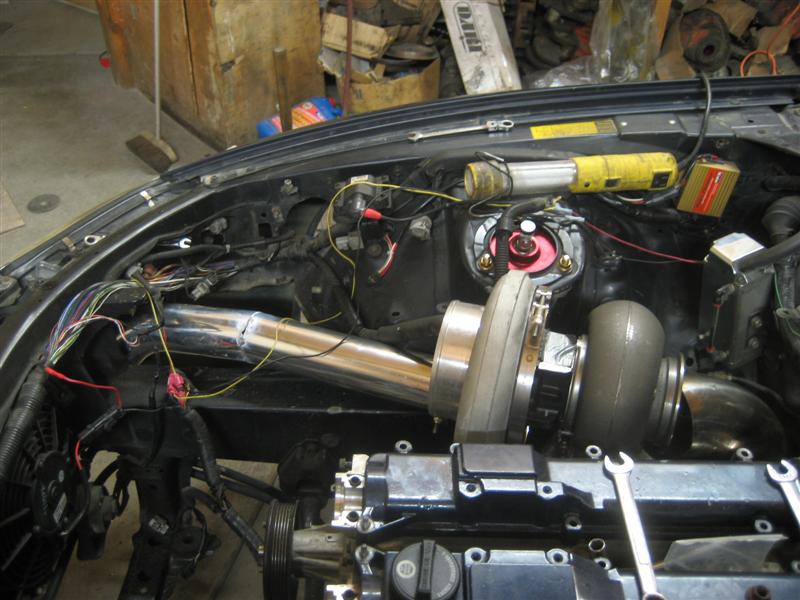

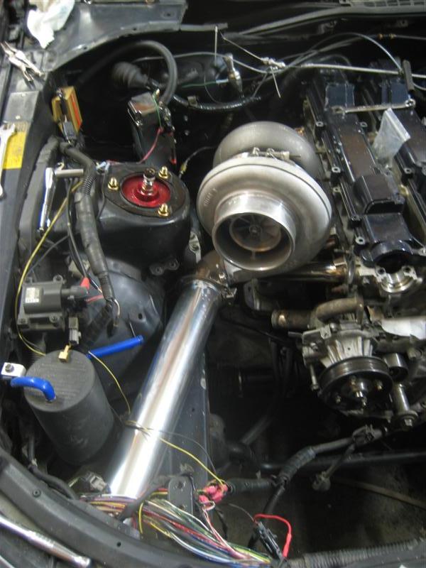

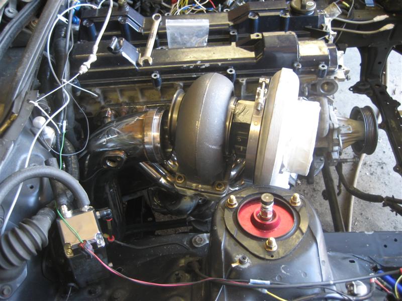

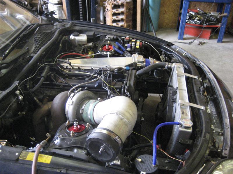

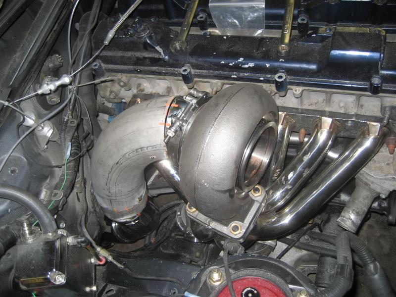

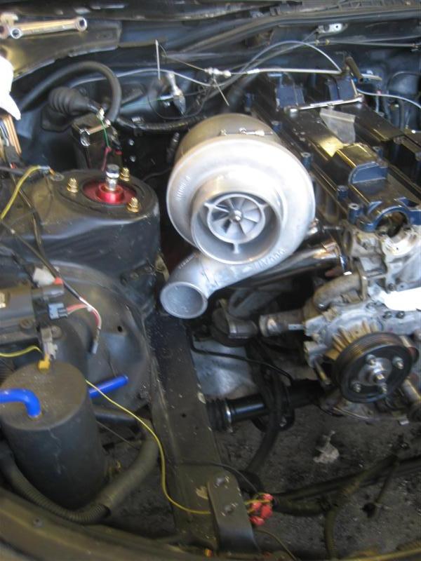

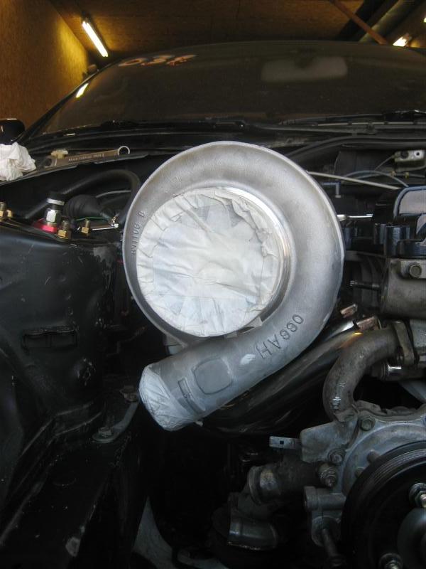

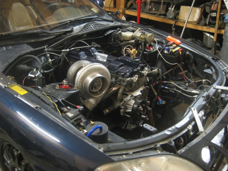

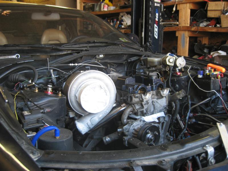

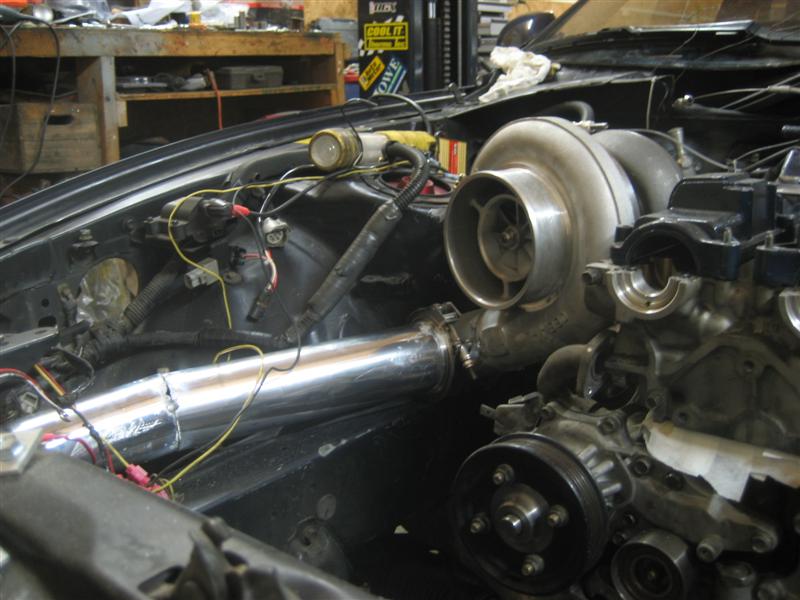

turbo installed. very small clearance with runner #1. for now, i ground off the casting bump 1/2 way around the compressor housing.
